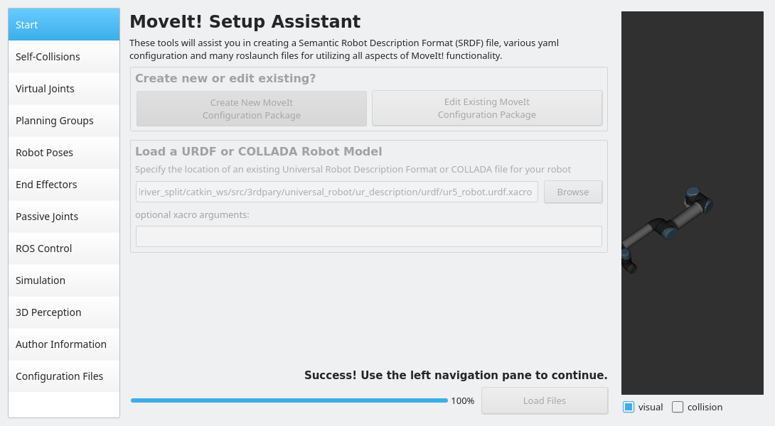

**Author:** ![anon42266160](https://avatars.discourse-cdn.com/v4/letter/a/53a042/32.png) [@anon42266160](https://forum.universal-robots.com/u/anon42266160)\
**Post date:** [May 12, 2021, 8:14am UTC](https://forum.universal-robots.com/t/how-to-move-ur-by-publishing-pose-into-ur-hardware-interface-script-command-in-python/13745/10 "2021-05-12T08:14:13Z")
where can i find URDF or COLLADA Robot Model to create New Moveit configuration package?
I want to start moveit! Setup Assistant, and i need to load URDF. I tried to use URDF from this:
/catkin\_ws/src/fmauch\_universal\_robot/ur\_description/urdf - there is 3 urdf files.
but i have always Error: URDF/COLLADA file is not a valid robot model.
Where can i find valid file to create own configuration?
**Author:** ![mauch](https://avatars.discourse-cdn.com/v4/letter/m/71e660/32.png) [@mauch](https://forum.universal-robots.com/u/mauch)\
**Post date:** [May 12, 2021, 2:04pm UTC](https://forum.universal-robots.com/t/how-to-move-ur-by-publishing-pose-into-ur-hardware-interface-script-command-in-python/13745/11 "2021-05-12T14:04:49Z")
`ur5_robot.urdf.xacro` seems to work for me:
 ![image](https://us1.discourse-cdn.com/flex020/uploads/universal_robots/original/2X/a/a5a9855d83ce6a0fac804278fe23e0b3056bbaa6.png)
