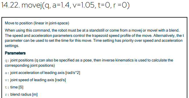

![image](https://us1.discourse-cdn.com/flex020/uploads/universal_robots/original/2X/5/59bd4c0d6cba1b268fe7a77ce5f5aa0a32773b71.png)
MoveJ does have a Time input parameter.
Yes a blend radius of 0 will stop at each point, so you’d have to put a very small blend I think.
