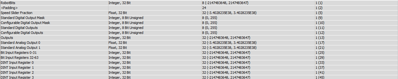

So, in the Universal Robots EDS, it shows bits 205 and 209 are the TCP position bits.
 ![image](https://us1.discourse-cdn.com/flex020/uploads/universal_robots/original/2X/1/18f7006506f32d2cc9235e28c078a560bb6ab3e1.png)
In the script manual that Eric provided, 17.32 Read\_Input\_Float\_Register should work right?
If I make a script,
```auto
float_val=read_input_float_register(205)
float_val=read_input_float_register(209)
But the script manual is saying registers 0:23 are reserved for fieldbus/PLC. What am I missing here?
**Post date:** [July 11, 2025, 1:07pm UTC](https://forum.universal-robots.com/t/how-do-i-get-keyence-laser-profiler-data-to-populate-variables-in-polyscope/40401/12 "2025-07-11T13:07:57Z")
Not trying to be pedantic here, the distinction is important. Those aren’t the BITS, those are the BYTES. You’ll notice they are all 4 apart, because the UR registers are 32-bits (4 bytes) large. The EDS file is breaking it into bytes (my Automation Direct PLC does the same thing).
The other important thing is to understand where the data is coming FROM and where it’s going TO. In my Automation Direct, I created a User Defined Type and called it UniversalRobot. I then gave it 2 arrays of bytes, and named them “From” and “To” so that when I use it, it looks like “UniversalRobot.From(205)”. This makes it clear that byte 205 is coming FROM the Universal robot, and in this case corresponds to the first BYTE of the X position of the TCP. In order to read the ACTUAL X value, you need to read bytes 205, 206, 207, and 208.
The read\_input\_float\_register() script command takes as input a REGISTER NUMBER OF THE ROBOT, not the byte number of the EDS file.
 ![image](https://us1.discourse-cdn.com/flex020/uploads/universal_robots/original/2X/4/4d79745dd3eb7bdcc6e879b2651aded0dcb7941f.png)
For example, in the PLC, I would read the Keyence data, and copy the value to bytes 33, 34, 35, and 36. You may need to use some kind of “unpack word” instruction if the Keyence data is a 32-bit value so you can split it across the 4 bytes in the PLC. Then in the robot, the script manual command you would use is “read\_input\_integer\_register(0)” because that is the register number that lines up with those bytes. Hopefully that makes sense.
Knowing your goal is realtime control of the robot, it’s worth pointing out that you cannot overwrite the TCP position from the PLC. You can only READ the tcp values via the PLC. To actually control it in real-time, the python implementation of the RTDE would be your best bet.
