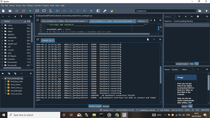

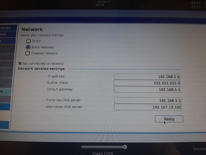

I am new in UR robot. I have a problem with connecting via IP to the UR. It is a UR series-10. sometimes it works but sometime I don’t have any connection with my UR. These are my network settings:
 ![Screenshot (249)](https://us1.discourse-cdn.com/flex020/uploads/universal_robots/original/2X/c/c7894cf01059c61d8b2f1ce049129d1bbe4e3759.png)
and I get timed out! message.

**Post date:** [April 24, 2024, 5:11am UTC](https://forum.universal-robots.com/t/getting-timed-out-error-with-ip-connection-with-static-network/33885/4 "2024-04-24T05:11:16Z")
So taking a quick look, it looks like you’re not using a router. Neither a DNS server in this case (as far as I know - I’m no network expert). 🙂
Remove the DNS IPs from the robot as well as the gateway. Your PC will then have 192.168.5.1 as IP and your robot 192.168.5.5.

I found the issue. It was due to incomplete run of the python program, so the laptop-robot connection route remained busy.
