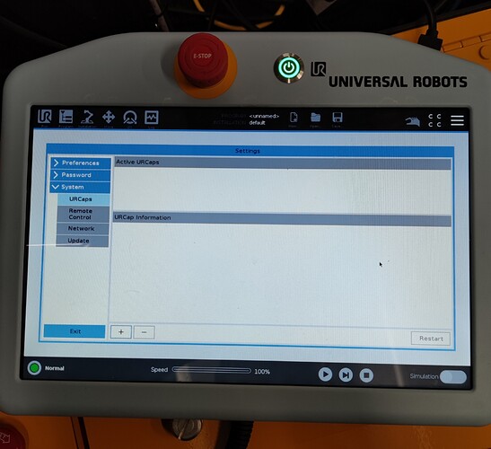

I am trying to install urcap file for robotiq wrist camera which I have downloaded from their website. After I select the urcap files from the usb, nothing come up. I am using polyscope 5.3 with ur10e.
 ![2098943675](https://us1.discourse-cdn.com/flex020/uploads/universal_robots/original/2X/b/b0b8721e305c64e212db311331073e0062b705c4.jpeg)

if you just downloaded the wirst camera URCap from Robotiq’s website, the latest version required Polyscope 5.8 +. You may want to try and update your Polyscope to the latest version.
Alternately, you can also post this concern (and all related) directly to Robotiq’s forum here : [https://dof.robotiq.com/](https://dof.robotiq.com/)
