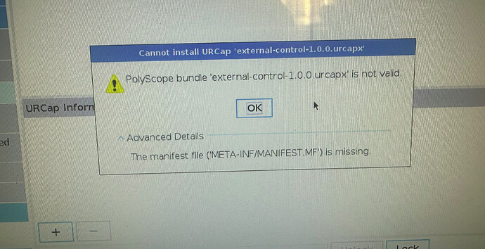

I’m currently setting up a **ROS 2 Jazzy** environment with a **UR7e** robot (e-Series, manufactured recently – August 2025).
The robot is running **PolyScope X version 74.23.218**.
When I try to install the **External Control URCap X** (required for ROS 2 control) I get the following error message on the Teach Pendant:
> `Cannot install URCap`
> ![Screenshot from 2025-10-20 14-28-45](https://us1.discourse-cdn.com/flex020/uploads/universal_robots/original/2X/a/a3da5ba050eb0f6b6901f799b7c868a28d5e8e4c.jpeg)
> `: Manifest file (META-INF/MANIFEST.MF) is missing`

1. Downloaded `externalcontrol-0.1.0.urcapx` from the official GitHub release page:
[https://github.com/UniversalRobots/Universal\_Robots\_ExternalControl\_URCapX/releases](https://github.com/UniversalRobots/Universal_Robots_ExternalControl_URCapX/releases)
2. Copied the file to a USB stick (root directory).
3. Installed via _Settings → System → URCaps → + (Add URCap)_.
4. The error appears when i select the file (external-control-0.1.0.urcapx).
I double-checked the file name and integrity, but PolyScope still refuses to install it.
It looks like my robot expects a **newer, signed URCapX package format** for the 74.x firmware.
**My questions:**
- Is there an updated version of the _External Control URCap X_ compatible with **PolyScope 74.x**?
- If not yet released, is there any workaround (for example using **RTDE** directly with the ROS 2 driver)?
- Should I request a signed URCap package from UR Support?
Any feedback or confirmation from users running PolyScope X 74 would be greatly appreciated! 🙏

Hi Sabrina,
sorry for a very late reply, but I just stumbled upon this topic and wanted to still provide an answer for anyone else looking at this.
From the Screenshot it looks like you are trying to install a PolyScope X URCapX File onto a PolyScope 5 System. This can not work. You will need to download the PolyScope 5 External Control URCap with the Ending “.urcap”
