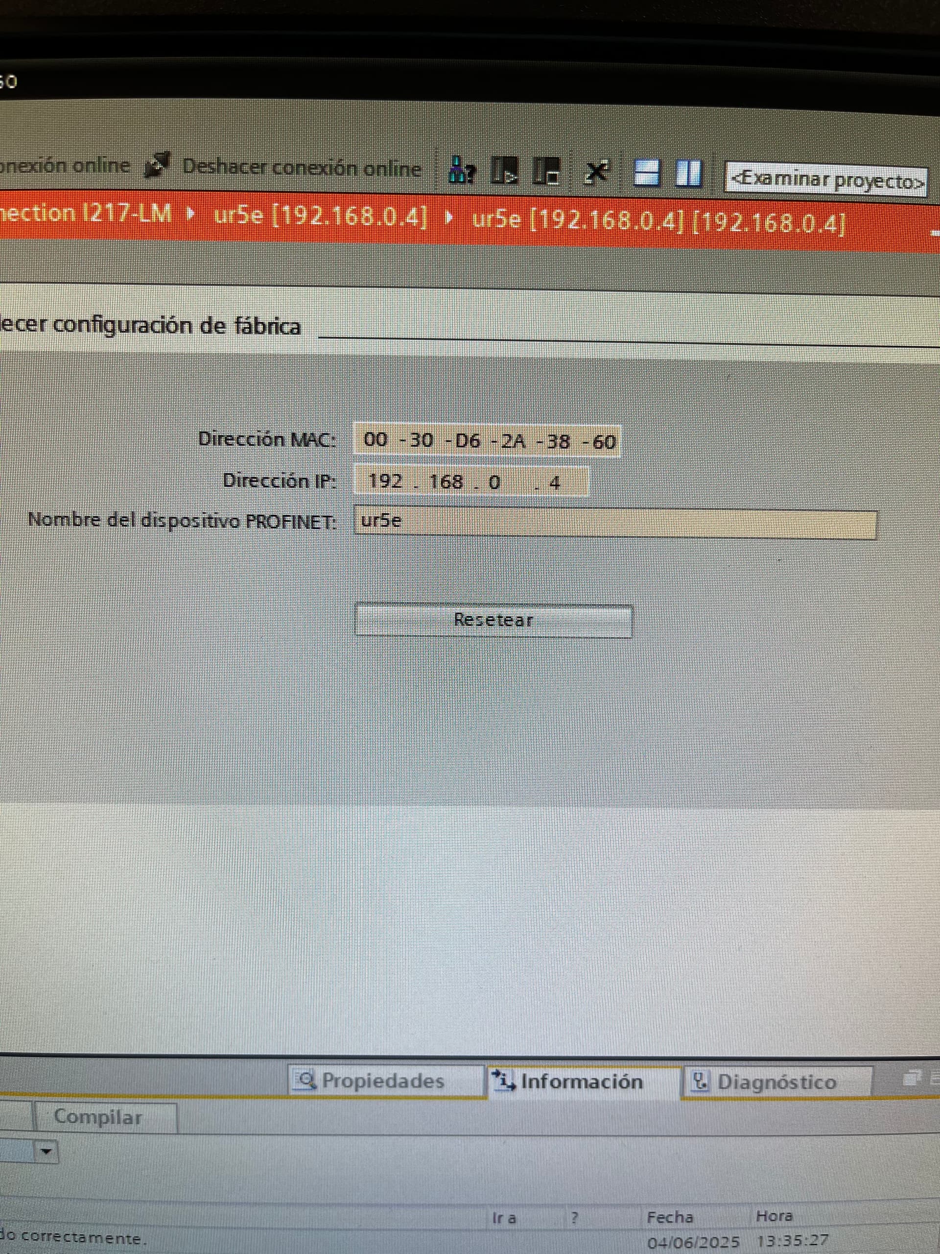

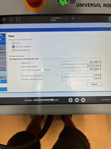

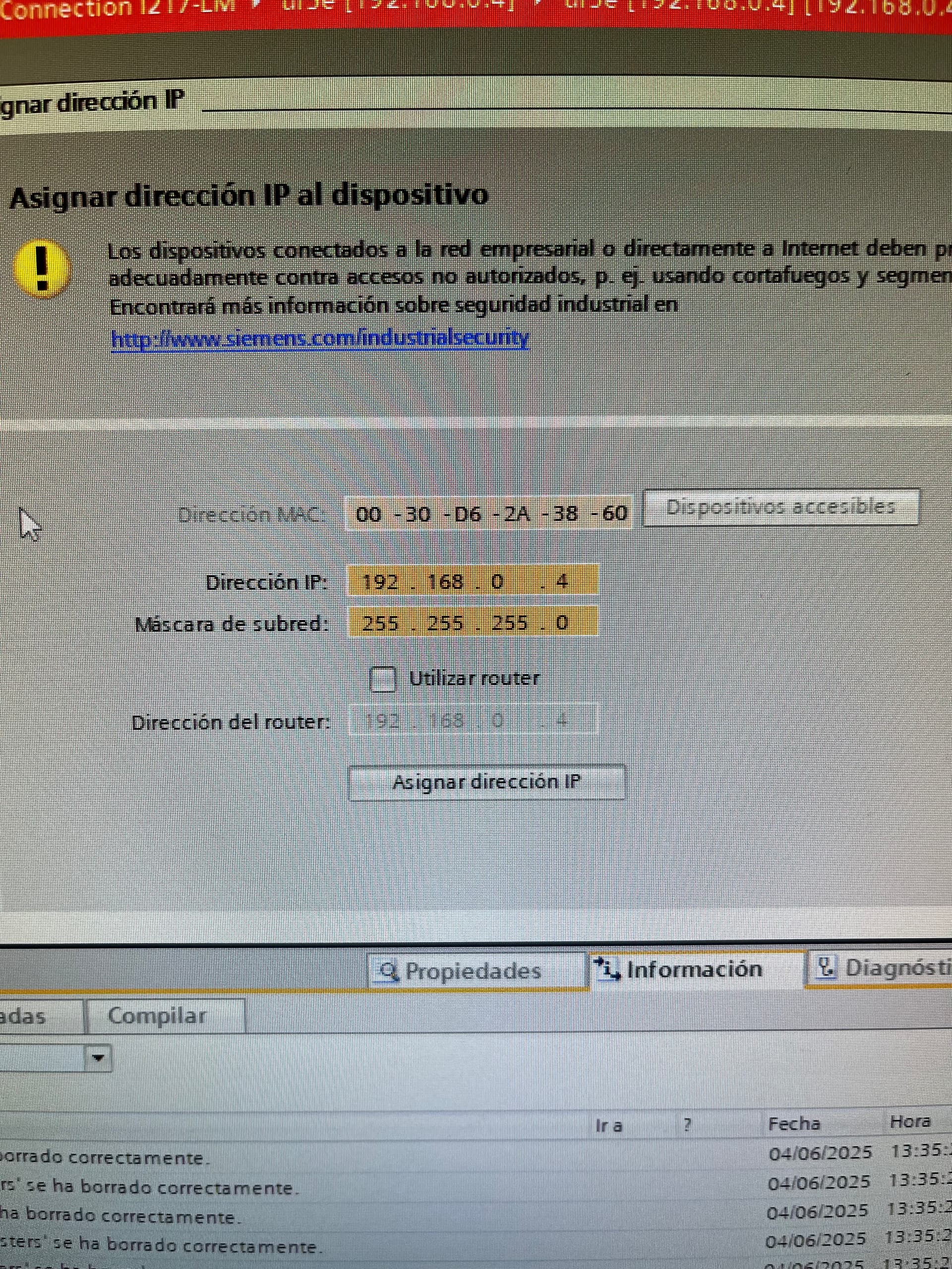

**Author:** ![a.alonsoa.2020](https://avatars.discourse-cdn.com/v4/letter/a/b5ac83/32.png) [@a.alonsoa.2020](https://forum.universal-robots.com/u/a.alonsoa.2020)\
**Post date:** [June 4, 2025, 11:28am UTC](https://forum.universal-robots.com/t/error-connecting-ur5e-arm-to-pc-with-ethernet-cable/40051/7 "2025-06-04T11:28:54Z")
I fixed the ping error between my pc and the robot, it was because my pc IP was 192.168.0.0, but I changed it to 192.168.0.20 and now it works.
Now i still cant connect the UR to the plc, I have a switch where i have 5 devices connected.
Where is the PROFISAFE option? Because I don’t find it.
I attach photos of my configuration, thanks for the help.
 ![IMG_9090](https://us1.discourse-cdn.com/flex020/uploads/universal_robots/original/2X/d/dbe8b28c53d3cd4bad7c3a9da6e600f411acbf8f.jpeg)
 ![IMG_9096](https://us1.discourse-cdn.com/flex020/uploads/universal_robots/original/2X/b/b865836c4e4aa78a1f2c43450fbbf349b5758e75.jpeg)
 ![IMG_9095](https://us1.discourse-cdn.com/flex020/uploads/universal_robots/original/2X/2/2116cad4c9b486a7bc4681dc4f4433ffb0a358ed.jpeg)
 ![IMG_9094](https://us1.discourse-cdn.com/flex020/uploads/universal_robots/original/2X/b/bb891d259e5fc54c52cf372ff6ef30d99d7c0c67.jpeg)
**Post date:** [June 4, 2025, 11:34am UTC](https://forum.universal-robots.com/t/error-connecting-ur5e-arm-to-pc-with-ethernet-cable/40051/8 "2025-06-04T11:34:35Z")
Delete this. You only use a gateway if you have a router:
 ![image](https://us1.discourse-cdn.com/flex020/uploads/universal_robots/original/2X/6/64c3a2ac79de445843408bac484b3674e340b7dc.png)
Have you done this?
 ![image](https://us1.discourse-cdn.com/flex020/uploads/universal_robots/original/2X/8/83abfbd0ae32449b965908d54ff8335aebd7aea9.png)
