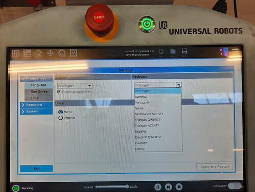

I am having trouble getting any connected keyboard to use a standard US English command. If I type “-” I get “+”. The only close option in Setup is Int’l English and that does not work.

Hi @christian.mackin,
This language option in setup will only change the onscreen language, not the keyboard input language. You’ll need to change this within Linux, I don’t have a real robot infront of me to check but I think you need to change the XKBLAYOUT line to =“us” in /etc/default/keyboard and then reboot.

Hi @ajp
conecting this thread [Keyboard setting](https://forum.universal-robots.com/t/keyboard-setting/14949)
I have the same problem, looked into your solution with our IT guy, but we don’t see a way to change the keyboard input language.
can you eleborate more about your solution?
would have tought to find it here:
 ![image](https://us1.discourse-cdn.com/flex020/uploads/universal_robots/original/2X/4/43a29dc3b7fb728e408924b3a0189a6bd6fd6c5b.jpeg)
thanks in advance,
Corné

Hi @anon32310726,
You need to do the following steps
1. Go to the terminal by pressing CTRL+ALT+F6
2. type in “root” as user and admin password default is “easybot”
3. type in “nano /etc/default/keyboard” and hit enter
4. modify the file according to @ajp instruction
5. press CTRL+X to exit and save changes
6. reboot the system
I hope that solves your challenge
Ebbe

Hi @anon32310726 ,
You could refer to this article to solve your problem.
[https://www.universal-robots.com/articles/ur/application-installation/changing-the-console-keyboard-layout/](https://www.universal-robots.com/articles/ur/application-installation/changing-the-console-keyboard-layout/)

@sya and @Ebbe,
thanks a lot for your help! the description worked for me 😀
