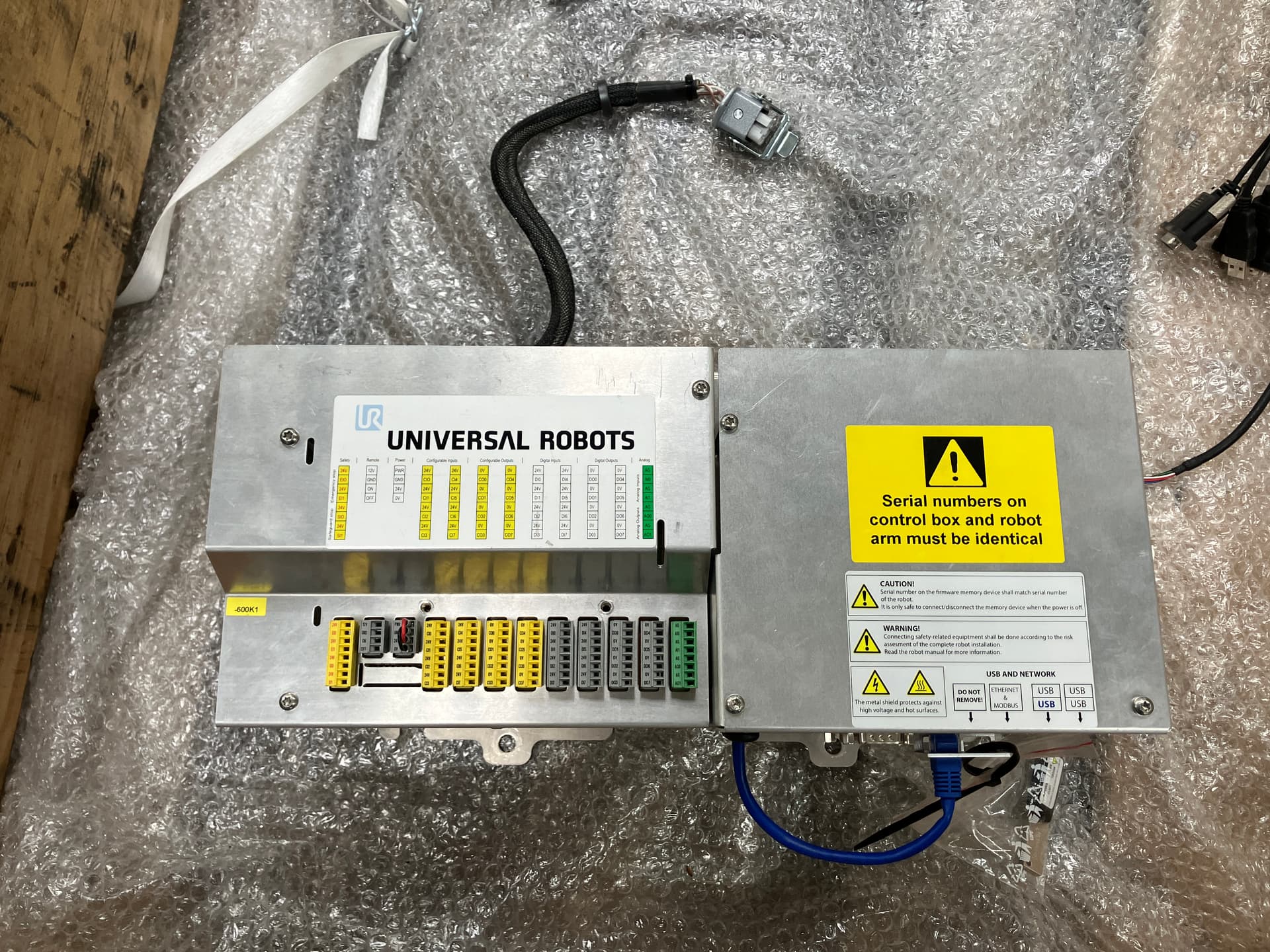

our company has purchased a used UR10 from a machine dealer. My colleagues and I are supposed to set up a test track. But first, we need to make the robot operational.
Our problems are as follows:

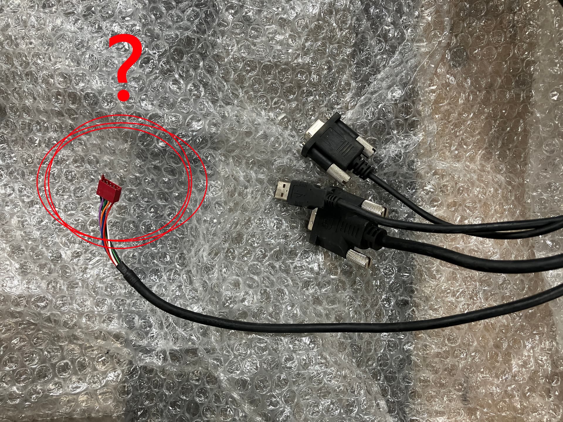

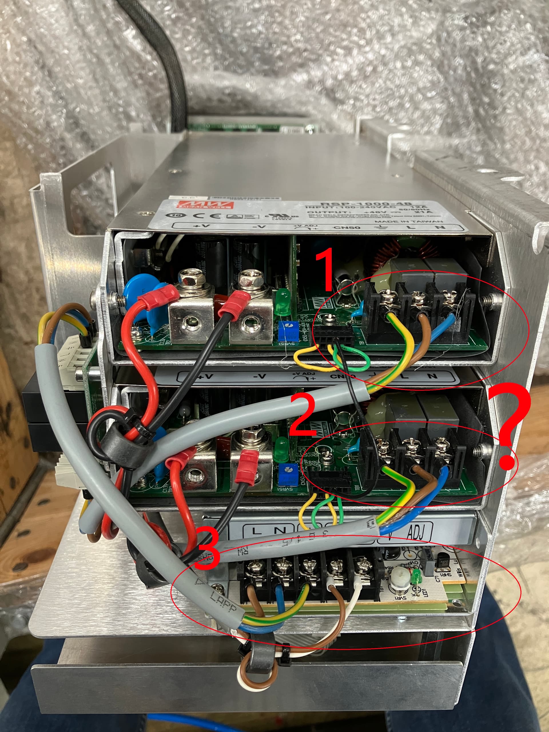

1. Unfortunately, the robot only comes with the controller. A control cabinet is missing. The power supply that leads to the controller is also missing. There should be a power line with a socket/IEC connector. Our electrician is willing to create something himself, but he is unsure where exactly to connect the wires. Perhaps you could provide some advice. I have taken photos to illustrate the situation better.
2. There is a red connector on the cable of the panel - see the picture. Where does this plug in?
 ![IMG_0919](https://us1.discourse-cdn.com/flex020/uploads/universal_robots/original/2X/1/1d57388b8a47675c10c19e6d48df01da7a167240.jpeg)
 ![IMG_0920](https://us1.discourse-cdn.com/flex020/uploads/universal_robots/original/2X/8/870bc9589755239e3783c95d9ee25b8d34d38394.jpeg)
 ![IMG_0921](https://us1.discourse-cdn.com/flex020/uploads/universal_robots/original/2X/3/382af257d9d61272d4e4161ffca62bfc9ad16016.jpeg)

Here’s the electrical diagram for the controller. It’s really fairly simple - just connect your supply to the Current Distributor (small PCB to the left of the PSUs on your 2nd image).
 ![image](https://us1.discourse-cdn.com/flex020/uploads/universal_robots/original/2X/b/bb97e6855f213ca5632939597468aca54a6113e8.png)
The red connector connects to RS485/12V on the Safety Control Board.
