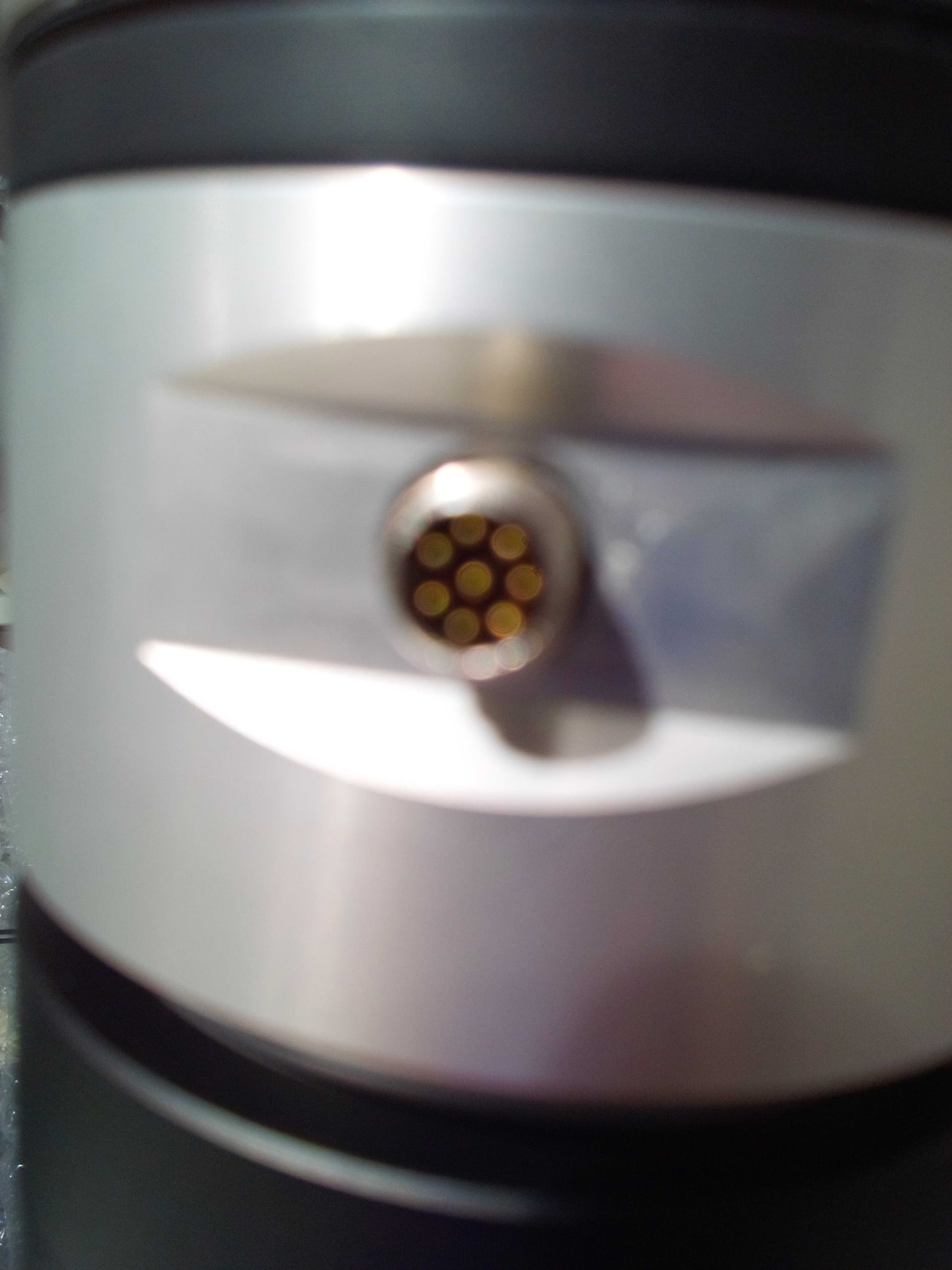

I have one Robotiq Hand-E Gripper and one UR5e. I would like to connect the Gripper over the Wrist I/O.
I sadly need an adapter for this.
Hand E has a 5 pin and the UR5e has an 8 pin. Is there even an Adapter for this?
 ![IMG_20220622_163220_2](https://us1.discourse-cdn.com/flex020/uploads/universal_robots/original/2X/b/bf8dd8ea1b85c9df0f6f638aac04a3f3ea0f27a5.jpeg)
 ![IMG_20220622_163232_6](https://us1.discourse-cdn.com/flex020/uploads/universal_robots/original/2X/1/15c1bb7fdbb0fc70fd528f66d5c124b86d686aea.jpeg)
 ![IMG_20220622_163135_2](https://us1.discourse-cdn.com/flex020/uploads/universal_robots/original/2X/0/0700e3fe34dd897ecfba897e6af067c6e9e7f457.jpeg)
