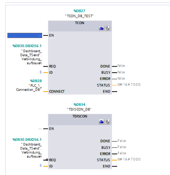

I´m struggling to get a running communication between my UR10e and my Siemens PLC (CPU 1212 TIA15.1) via Dashboard Server.
To do the data exchange I use a OUC Communication which is established via TCON (and deactivated via TDISCON):
 ![image](https://us1.discourse-cdn.com/flex020/uploads/universal_robots/original/2X/e/e9565a052d3d4dc327a2fa4b2068a888bf636681.png)
For sending and receiving data i have to use the blocks TSend and TRCV:
