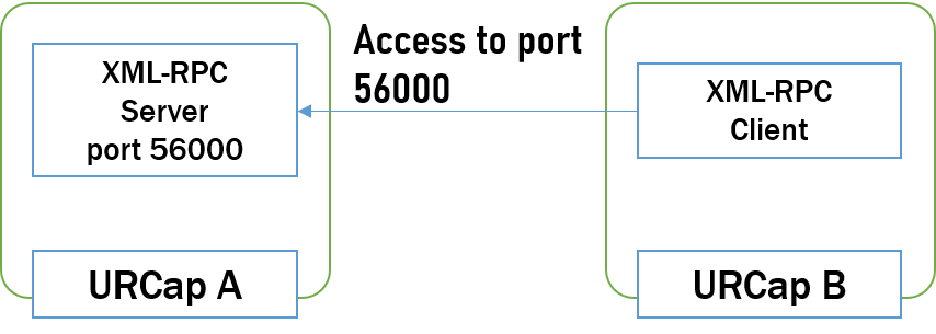

Can two urcaps access a single shared daemon running on a single xmlrpc server? One of the caps would be responsible for spinning up the server, and each cap would have its own instance of an xmlrpc interface class. I have two caps that have different functionality, but I want to share data between them, and I am wondering if this is an option or if I should combine the two into a single cap?

Hi, it is possible to access daemon on another urcap.
Because daemon of xmlrpc server is actually independent application.
 ![access](https://us1.discourse-cdn.com/flex020/uploads/universal_robots/original/2X/e/e1eb7dcf098d2a7ddb7d065f18f9b2b8760a4fd2.png)
