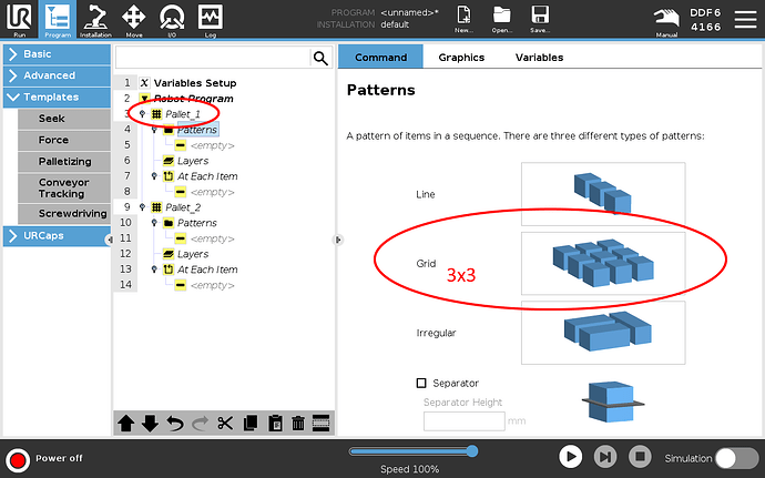

Very new to the UR5e and Polyscope (Version 5.24) so still learning the basics…
The task is to move 9 items from a 3x3 grid to a 5x4 pattern, the 4 item row being offset from the 5 item row as shown below:
 ![Screenshot9](https://us1.discourse-cdn.com/flex020/uploads/universal_robots/original/2X/1/16dc96da78a7b51b654b5d2386d33f4701914092.png)
Is this possible?
As mentioned, I’m new to this so any help will be greatly appreciated!
**Author:** ![thomas.denepoux.pro](https://sea2.discourse-cdn.com/flex020/user_avatar/forum.universal-robots.com/thomas.denepoux.pro/32/7365_2.png) [@thomas.denepoux.pro](https://forum.universal-robots.com/u/thomas.denepoux.pro)\
**Post date:** [November 24, 2025, 4:32pm UTC](https://forum.universal-robots.com/t/3x3-grid-to-5x4-offset-palletizing-is-this-possible/41803/2 "2025-11-24T16:32:31Z")

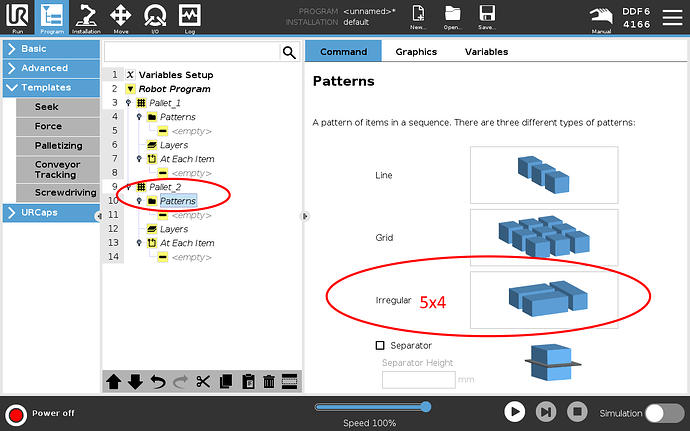

I think the simplest solution is to perform a 3x3 grid depalletization using the UR template followed by an irregular palletization containing 9 items that represent your 5x4 pattern, also using the UR pattern.

**Author:** ![nweaver](https://avatars.discourse-cdn.com/v4/letter/n/8edcca/32.png) [@nweaver](https://forum.universal-robots.com/u/nweaver)\
**Post date:** [November 25, 2025, 7:04am UTC](https://forum.universal-robots.com/t/3x3-grid-to-5x4-offset-palletizing-is-this-possible/41803/3 "2025-11-25T07:04:45Z")
Thank you, I will give this a go!
**Post date:** [November 25, 2025, 9:01am UTC](https://forum.universal-robots.com/t/3x3-grid-to-5x4-offset-palletizing-is-this-possible/41803/4 "2025-11-25T09:01:37Z")
Did this help you?
Otherwise, what problems are you encountering?
**Post date:** [November 25, 2025, 10:35am UTC](https://forum.universal-robots.com/t/3x3-grid-to-5x4-offset-palletizing-is-this-possible/41803/5 "2025-11-25T10:35:02Z")
It did, thank you for your help!
**Author:** ![andrew2](https://avatars.discourse-cdn.com/v4/letter/a/58956e/32.png) [@andrew2](https://forum.universal-robots.com/u/andrew2)\
**Post date:** [December 1, 2025, 1:40am UTC](https://forum.universal-robots.com/t/3x3-grid-to-5x4-offset-palletizing-is-this-possible/41803/6 "2025-12-01T01:40:50Z")
Another option is to implement the destination as two single line patterns a 1x5 & 1x4. You can then either alternate between the patterns or complete one pattern followed by the other depending on the order you want them to be stacked.
**Author:** ![james.mccormick](https://avatars.discourse-cdn.com/v4/letter/j/b3f665/32.png) [@james.mccormick](https://forum.universal-robots.com/u/james.mccormick)\
**Post date:** [December 1, 2025, 2:36pm UTC](https://forum.universal-robots.com/t/3x3-grid-to-5x4-offset-palletizing-is-this-possible/41803/7 "2025-12-01T14:36:22Z")
Teach pose for top left position, PoseTL. Then each pose in pallet is just a vector translation in X and Y =\> PoseOffset=[X1,Y1,0,0,0,0]. PoseNext = postrans(PoseTL, PoseOffset). Top row just has X offset, Xn=X0+i\*XOffset. Bottom row has X0+i\*XOffset and Y=YOffset, where i=1..5 This is basic DIY palletizing the old school way.
**Post date:** [December 1, 2025, 2:46pm UTC](https://forum.universal-robots.com/t/3x3-grid-to-5x4-offset-palletizing-is-this-possible/41803/8 "2025-12-01T14:46:44Z")
Thank you @andrew2 and @andrew2 , the method suggested by @thomas.denepoux.pro did the trick.
